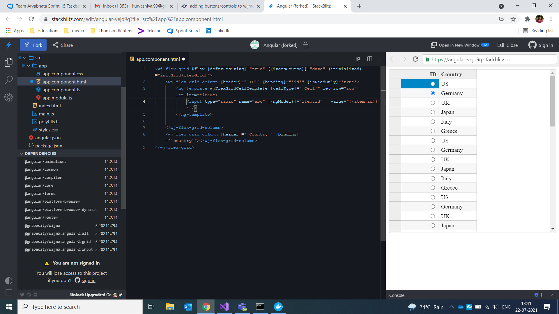

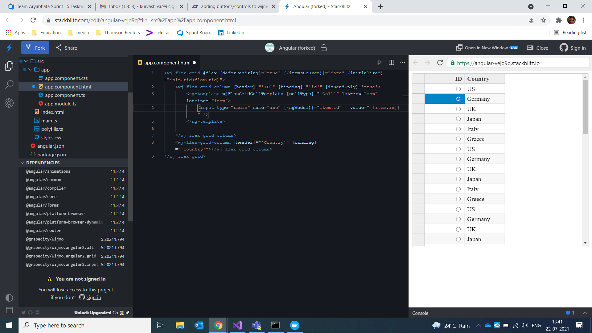

    Hello Mr. Sharad Tomer ,
    Thank you for the solution. But there are few problems with the given solution.
    Firstly , ’ name attribute ’ is not included for the radio button element which I made sure to include so that it would work just like a radio button.
    The main issue is that ,once a radio button is selected it’s id getting changed to a string. so when we I select another radio button and if I want to select the previous radio button , I am unable to select it . ( see images for reference )
    i.e. We are able to select the radio buttons only once . if we click a button once we can’t select it again. please give me a better solution ASAP.
    ( please add name attribute for the radio button element )
  • Posted 25 July 2021, 8:28 am EST
    Thank you for the additional information. The last shared sample didn’t have any functionality related to the radio button, it was just to demonstrate the clicking functionality, To select only a single item, you may bind the radio button with a class property. Please refer to the following sample demonstrating the same:
