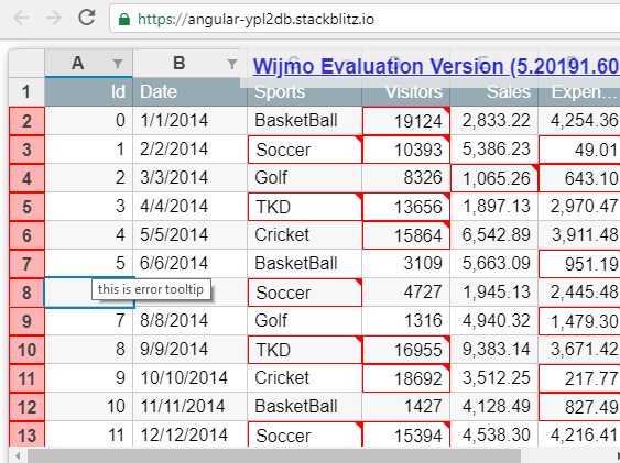

    We are sorry but we were unable to replicate the issue at our end. The sample provided is working as expected in the latest version. Please refer to the above sample with the updated version of wijmo:
    https://stackblitz.com/edit/angular-ypl2db

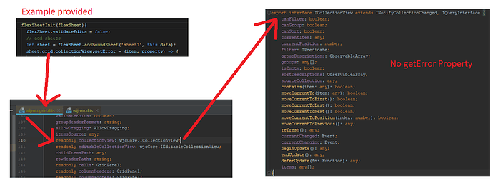

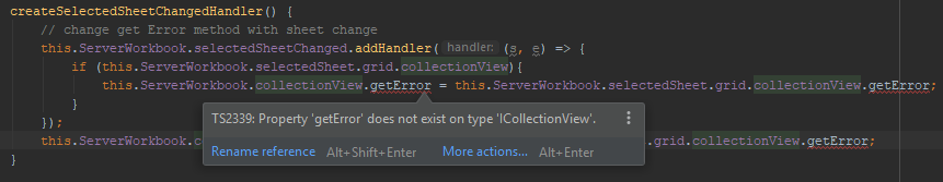

    Is there something I am missing?
    The property getError doesn’t exist on ICollectionView. I see a getError function on CollectionView (notice no I, not an interface), but on a wijmo flexsheet grid, collectionView is typed as the former, and therefore the code doesn’t compile for me as is shown in the example.
  • Posted 24 April 2019, 4:29 am EST
    ICollectionView interface doesn’t have ‘getError’ property but CollectionView class have one and the actual instance which is assigned to a collectionView property of the FlexGrid is an object of CollectionView class.
    And since tsc works during the compile time and doesn’t know that the actual instance would be an object of CollectionView class it shows the error.
    To fix the issue we could simply cast it like:
    (this.ServerWorkbook.collectionView as wjcCore.CollectionView).getError = myGetErrorFunction;
    ~Sharad
