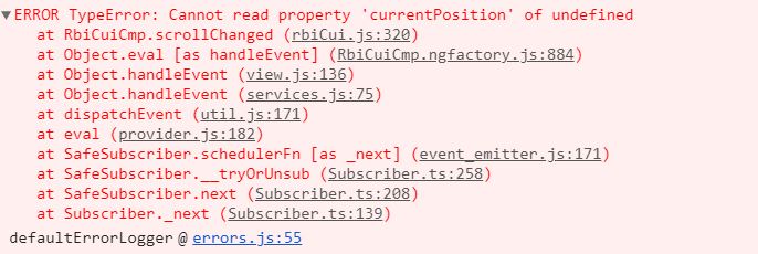

    1st 20 records load with this console error cannot read property "CurrentPosition "
    while scrolling down, next 20 records not appending, only starting same 20 records remains there in Grid.
    Debugging into it “CurrentPosition” shows 0
    while scrolling, scrollChanged() function is call everytime .
