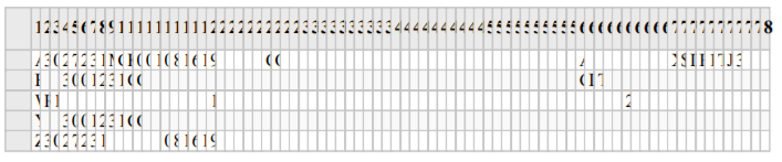

    I’m trying to change the column width to only fit one character using css but it leaves a blank space between the columns. Please see attachment. Is there a way to give rid of it?

    But it messes up the PDF export. Please see attached.
    Is there a way to export/print the grid as is?

    I think I know why it’s exporting my grid the way it is. I removed the cell borders and cell padding with css but the PDF export are not aware and kept those so the columns all look squished. Please see attachment for what the grid looks like rendered on my screen with the css changes.
    CSS:
    .abi-message-viewer .wj-cell {
    padding: 0;
    border: none !important;
    text-align: center;
    Is it possible to add those css to the PDF export too?

    The pdf converter does not know about the CSS applied. You can use the formatItem callback while exporting the grid to apply the style to the cells. Please refer to the demo link below:
    https://www.grapecity.com/wijmo/demos/Grid/ImportExportPrint/PDF/CustomCellContent/angular
    In this demo, observe how the formatItem event is used to draw images. Similarly, you can also perform other functions like canceling the rendering of borders. Refer to the link below for the complete API:
    https://www.grapecity.com/wijmo/api/classes/wijmo_grid_pdf.pdfformatitemeventargs.html

    Thanks for linking those examples. I was able to use the formatItem callback to set the cancelBorders property. Doesn’t look exactly like what we have rendered on the page but close enough.
