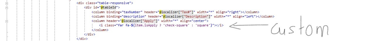

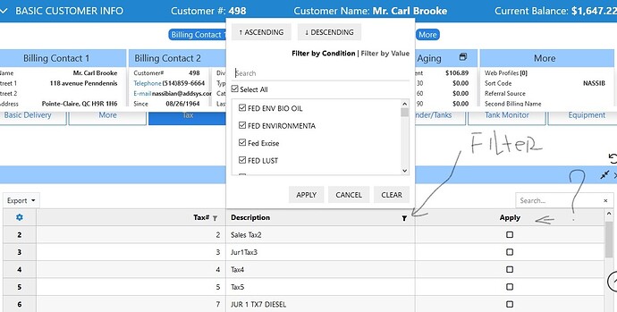

    Good day. We want to implement filtering and sorting for custom columns with boolean values. We implemented in wijmo grid wrapper function for filtering and sorting but doesn’t work for a custom column.

    Good day. It will be difficult because we have an ASP.NET Core application and inside we have some JS code with Wijmo grid implementation. Can you provide me an example of custom column implementation with boolean value ?

    Please refer to the following sample which demonstrates the correct way of inheriting from wijmo component and using wj-flex-grid-filter with custom column components:
    https://codesandbox.io/s/wijmo-angular-forked-5u155?file=/src/app/app.component.html
