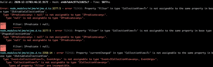

    However when I tried it in a small Angular 11 project. I encountered many TS2416 errors:
    Build at: 2020-12-11T03:46:32.917Z - Hash: e4db7ab4c977e31025c7 - Time: 5077ms
    Error: node_modules/wijmo/wijmo.d.ts:3277:5 - error TS2416: Property 'filter' in type 'CollectionView<T>' is not assignable to the same property in base type 'IEditableCollectionView'.
      Type 'IPredicate<any> | null' is not assignable to type 'IPredicate<any>'.
        Type 'null' is not assignable to type 'IPredicate<any>'.
    3277     filter: IPredicate | null;
    node_modules/wijmo/wijmo.d.ts:3277:5 - error TS2416: Property 'filter' in type 'CollectionView<T>' is not assignable to the same property in base type 'IPagedCollectionView'.
    node_modules/wijmo/wijmo.d.ts:3358:14 - error TS2416: Property 'currentChanged' in type 'CollectionView<T>' is not assignable to the same property in base type 'IEditableCollectionView'.
      Type 'Event<CollectionView<T>, EventArgs>' is not assignable to type 'Event<ICollectionView<any>, EventArgs>'.
        Type 'CollectionView<T>' is not assignable to type 'ICollectionView<any>'.
          Types of property 'filter' are incompatible.

  • Posted 11 December 2020, 2:13 am EST
    After suppressing the Typescript errors. I got more related to Angular Ivy compiler:
    This likely means that the library (wijmo/wijmo.angular2.grid.search) which declares WjGridSearchModule has not been processed correctly by ngcc, or is not compatible with Angular Ivy. Check if a newer version of the library is available, and update if so. Also consider checking with the library's authors to see if the library is expected to be compatible with Ivy.
