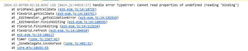

    We have recently updated to Angular 16 and using a version of Wijmo which supports it we are encountering the following error on navigating in the app using the Angular router
    This occurs if we use the getError validation on the wj-flex-grid with wj-flex-grid-columns defined and if we leave the cell in an error state when navigating away using the angular router (ie router.navigate or [routerLink] it generates this error.
    I have replicated this issue using the latest available package and Angular 18. See below for code example. Can you advise on a possible solution? We can try to use hrefs but its not an ideal situation and the use of the Angular router is pretty important.

    Having noticed a nightly build posted on (https://developer.mescius.com/forums/wijmo/transposed-table-getbindingcolumn-error) which seems similiar. I tested it out and it seems to work.
    When is the possibility of 5.20242.23-nightly.d20241128.t020206 being released?
  • Posted 6 December 2024, 3:17 am EST
    Hi Jack,
    Thank you for sharing the additional information, it seems you are now aware that this is a known issue and has already been fixed in the latest nightly build. The tentative date for the upcoming Wijmo release i.e. 5.20242.HOTFIX is 18 December.
    In case, you need any other help, please let us know.
