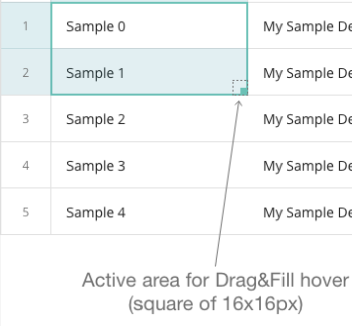

    I want to increase area which trigger autofill functionality. How can I make it?

    You may handle the mousemove event and set the cursor to crosshair to extend the dragfill trigger area. You may refer to the followng code snippet and the sample demonstrating the same:
    flexsheet.hostElement.addEventListener("mousemove", (e) => {
          let htInfo = flexsheet.hitTest(e);
          if (
            !htInfo ||
            !htInfo.panel ||
            htInfo.panel.cellType !== wjGrid.CellType.Cell
            return;
          // is selection
          if (!flexsheet.selection.contains(htInfo.row, htInfo.col)) {
            return;
          // is cell the bottom-right cell in selection
          if (
            flexsheet.selection.rightCol !== htInfo.col ||
            flexsheet.selection.bottomRow !== htInfo.row
            return;
          // check edge
          let pt = htInfo.point;
          let cellRect = flexsheet.cells.getCellBoundingRect(
            htInfo.row,
            htInfo.col
          if (pt.x < cellRect.right - 16 || pt.y < cellRect.bottom - 16) {
            return;
          flexsheet.hostElement.style.cursor = "crosshair";
    https://codesandbox.io/s/wijmo-angular-forked-xp6hi?file=/src/app/app.component.ts
    ~sharad
  • Posted 23 April 2021, 8:40 am EST
    It works! Many thanks for the quick reply
