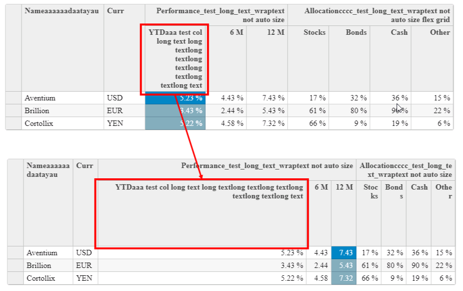

    When the text header is too long, I want to WRAPTEXT and automatically adjust the HEIGHT to display full text
    and I have to use s.autoSizeRows (0, s.rows.length-1, true) to do that.
    But after I use merge header, autoSizeRows height cannot be adjusted automatically.
    Refer to the green frame of image below.

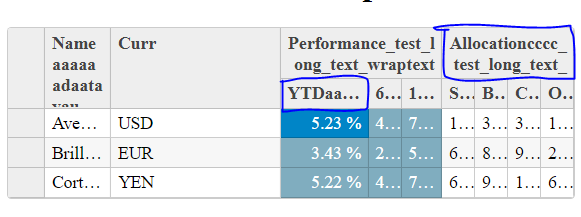

    when I resize the column header, the height of the header does not change

    The rows do not automatically resize their height. To resolve this, you may handle the resizedColumn event of the FlexGrid and call the autoSizeRows method to resize the rows. Please refer to the updated sample below:
    https://jsfiddle.net/ypuebdc5/8/
