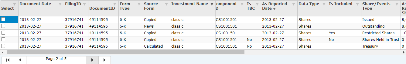

  • Posted 2 February 2021, 5:15 am EST - Updated 3 October 2022, 2:32 pm EST
    Hi Sharad,
    I can share a pic which is help you to understand my case.
    In this we use pagination and its divided into 3 pages. So If I tried to apply a filter with document Id then its apply on only our first page but our requirement is that filter would be apply on all 3 pages.

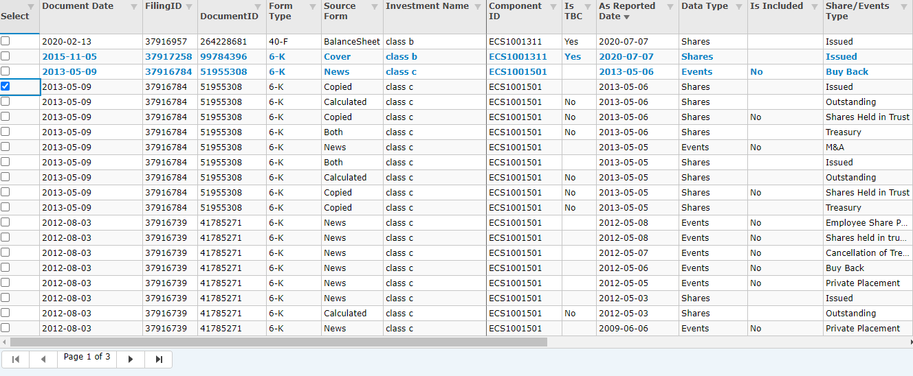

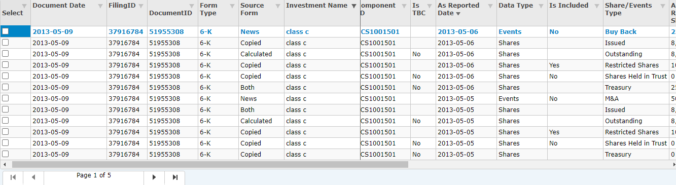

    Hi Sharad,
    Here one more query related pagination get update on total filtering data!
    User wants to view all filtered data in single page if number of filtered data is less then total number of page size.
    Ex: If we filtered Invest name with class c than its filtered properly but its show 10 rows on first page and 5 rows on second page and third page its shows 8 rows.
    Have we any way where when we apply filter for any value the pagination get update on total filtered rows.

  • Posted 12 February 2021, 4:29 am EST
    Hi Deepak,
    The requested feature is supported by wijmo out of the box. We do not need any additional configuration for this to work. You may test the same with the previously shared sample. In the sample apply filter on country column to show only “Japan” and observe that all the data is displayed on the first page.
    If you are having some issues, please share a small sample that replicates the issue so that we could further investigate it and assist you accordingly.
