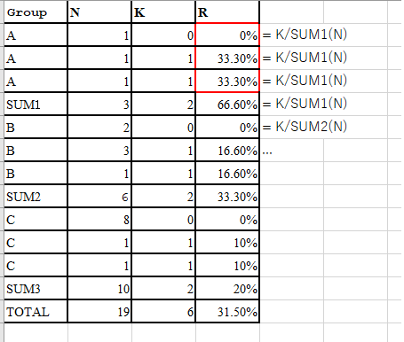

    There is a way to get Group Row item value from detail row?
    Following custom aggregation example on demo site , thru grid formatitem handler, we can check if that is stay in group row and easily to get group value.
    but, if cell is not in group rows (-means detail row) , can we get the group row object which cell is belongs to?
    For example , how can caculate ColC valule below
    by exp ColC = ColB/Sum(colB)

    i re attach image for example
