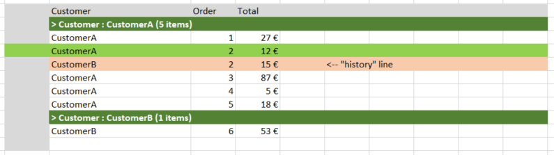

    I’ve got a WjFlexGrid that already has with many controls : sorting, filtring, grouping, …
    Now when a line is selected, I’ve got to show a line just below the selected one, with historical data.
    See attachment :
    Implementation
    I’ve tried some ways
    With a flexgrid and hiding rows
    The main problem is : I can’t have the history line certainly follow its parent line, because of sorting, grouping…
    With multirow
    Having historical data directly attached to the item is OK, but I’d have to update the layout to show two lines for the selected line only. It seems to be impossible.
    Do someone has an idea how to accomplish this ?
    Thank you in advance !
  • Posted 7 January 2021, 3:03 am EST
    You may use the DetailRow functionality to achieve the required functionality. Please refer to the following sample which demonstrates the same:
    https://codesandbox.io/s/wijmo-angular-forked-q2wj3?file=/src/app/app.component.ts
    You may also checkout the following demo for DetailRow:
    https://www.grapecity.com/wijmo/demos/Grid/Master-Detail/NestedGrids(RowDetail)/angular
    Sharad
  • Posted 7 January 2021, 5:48 am EST
    Thank you sire, exactly what I was looking for !
