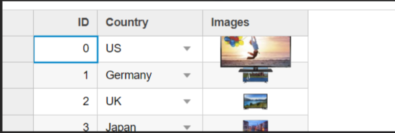

    Hi team,
    We followed the below link to create cellmaker image. But the image is getting cut for the first cell.
    https://www.grapecity.com/wijmo/demos/Grid/CustomCells/CellMaker/Images/angular
    I’ve attached a screenshot of the same
  • Posted 12 September 2023, 11:13 pm EST
    To show the image above the columnHeader cell when hovered, you may increase the z-index of the image on hover to 2. This will make the image element appear above the columnHeader cells. Please refer to the below code snippet:
    .wj-flexgrid .wj-cell.cell-img:hover {
       z-index: 2 ;
        overflow: visible;

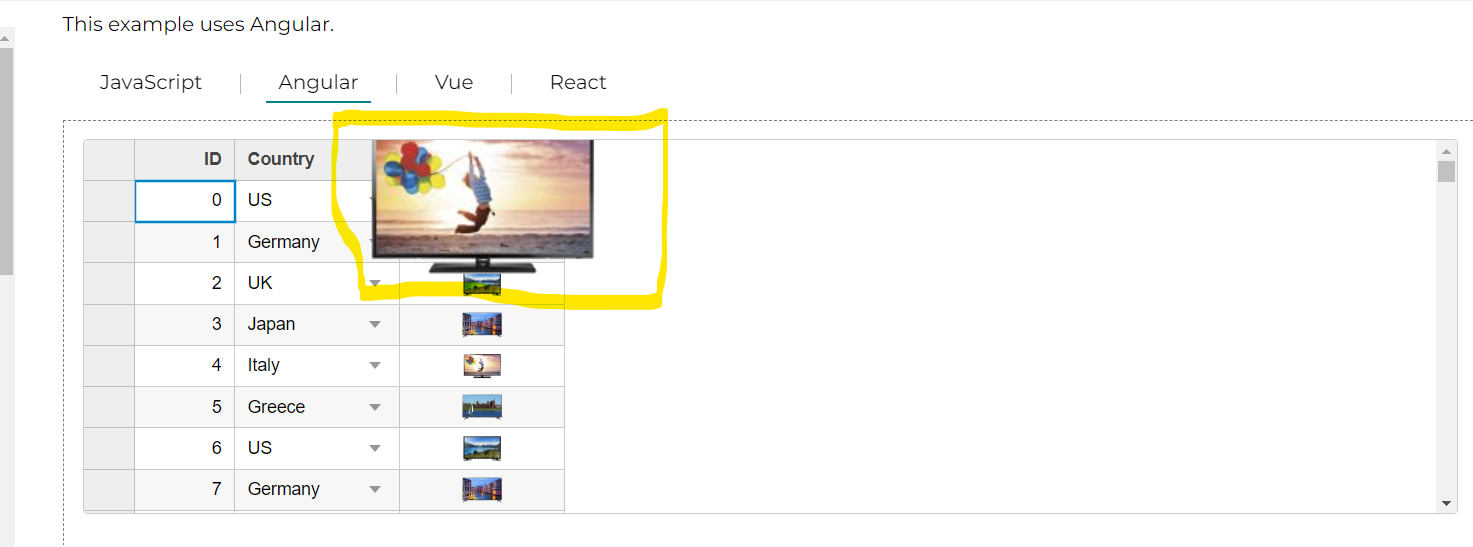

  • Posted 21 September 2023, 2:39 am EST - Updated 21 September 2023, 2:45 am EST
    Thanks for the reply. We had one more issue,
    Previously image was getting cut at the header, now it is getting cut at grid level. We want the image to pop out of the grid and be completely visible.
    We have attached the screenshot of the same. Please could you look into it.
  • Posted 22 September 2023, 7:06 am EST
    Sorry, but it wouldn’t be possible due to the current design structure of FlexGrid control. The only way I could find to show the image outside the boundaries of FlexGrid is to set the overflow selector for FlexGrid and let its child elements use that overflow value by inheriting it. But this leads to a distorted grid layout.
    However, you can use Wijmo tooltip control to show the images over a tooltip when hovering over the image cells. Please refer to the sample link below:
    https://stackblitz.com/edit/angular-sypwjs?file=src%2Fapp%2Fapp.component.html,src%2Fapp%2Fapp.component.ts
    API link: https://www.grapecity.com/wijmo/api/classes/wijmo.tooltip.html
