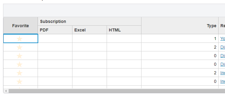

  • Posted 5 February 2021, 8:20 am EST - Updated 3 October 2022, 2:34 pm EST
    1)when i binded data favicon not able changed based on the binding data,it is always in inactive mode for all entire column,
    2)is it possible to integrate angular properties.i have tried to implement bur favorite icon is not able getting effected.when i click active(favicon() move to cursor point out of the cell immediatly inactive field goes away.

  • Posted 9 February 2021, 5:36 am EST
    You also need to refresh the CollectionView after updating the value of Favorite accordingly:
    getF(s:wjcGrid.FlexGrid,e){
    debugger;
    let col = s.columns[e.col].binding;
    // update the original value
    // when the ratin start is clickced
    if (col === “Favorite”) {
    const item = s.rows[e.row].dataItem;
    item.favorite = !item.favorite;
    s.collectionView.refresh();
    Regarding 2nd query, sorry, but adding angular properties will not be possible.
