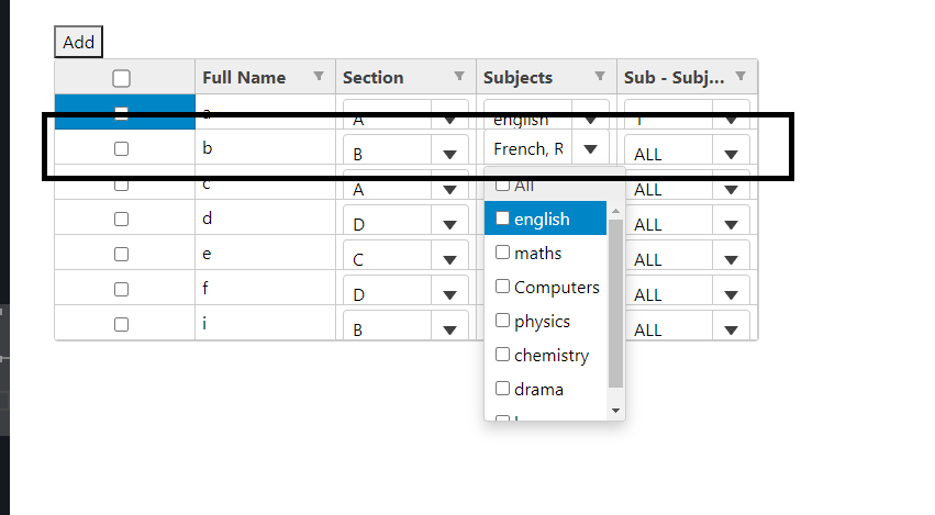

    Hi team,
    How can i achieve the below functionality -
    If i click on a cell and values present in that cell are not part of the associated collection of the cell then the cell value should get clear.
    Example -
    In 2 row and in subjects column - “French, Russian” is the cell value but it is not part of the respective cell collection.
    So when i click on that cell, the cell value should get cleared .
    Snippet of the above example -
    https://stackblitz.com/edit/angular-e3228b?file=src/app/app.component.ts
    Please help us with the solution.

  • Posted 17 June 2021, 5:28 am EST
    You may handle the isDroppedDownChanged method to clear the value. You may refer to the following updated sample:
    https://stackblitz.com/edit/angular-j5suuk?file=src/app/app.component.ts
