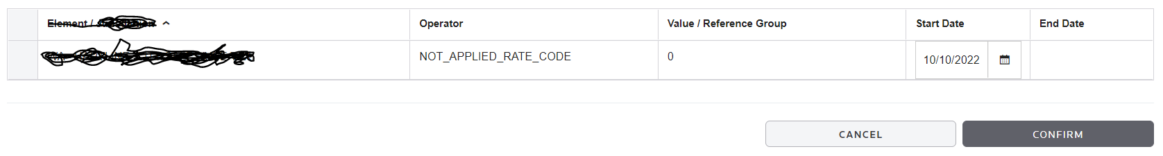

    In Angular Form wijmo grid used to add reocords inline, after entering record data inline while clicking outside of grid the data is not inserting

    We used wijmo grid on an Angular Form, allowed to Add record by inline, once the data is entered in the row and by clicking outside the data should save by the grid. But after completion of rowDataEditing and by clicking outside the grid data is not saved properly.

    As per our understanding, your inline record data is not saved when you click outside the grid, to avoid this from happening you can use flexGrid’s ‘lostFocus’ event to save your data.
    You can refer to this sample for full implementation https://jscodemine.grapecity.com/share/R2m3BlRmVkmR3OixxRLJbw/
    If there is something we missed or your issue is somewhat different from this, please update this sample to replicate your issue and share with us.
