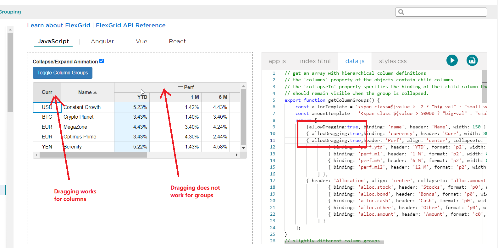

    It appears that dragging column groups does not work. For example, if I use this example: https://www.grapecity.com/wijmo/demos/Grid/Columns/ColumnGroups and I change the data.js by adding “allowDragging:true” then column dragging works but column group dragging does not appear to work - please see attached image for reference:
    Is there a way to it work?

    You will also need to set allowDragging property of the child columns because these columns will be the ones which you will actually drag.
    But, due to the design of the columnGroups the dragging in groups will not work properly. So, instead of only setting allowDragging property, you should also handle the draggingColumnOver event to restrict column dragging from and to certain positions.
    In this sample, you can only drop the column if the parent column is the same.
    https://stackblitz.com/edit/angular-udpdbx
