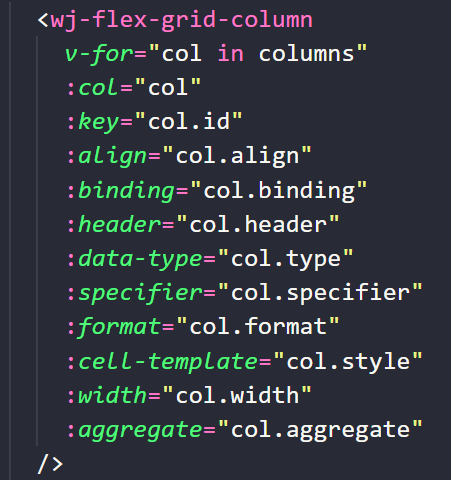

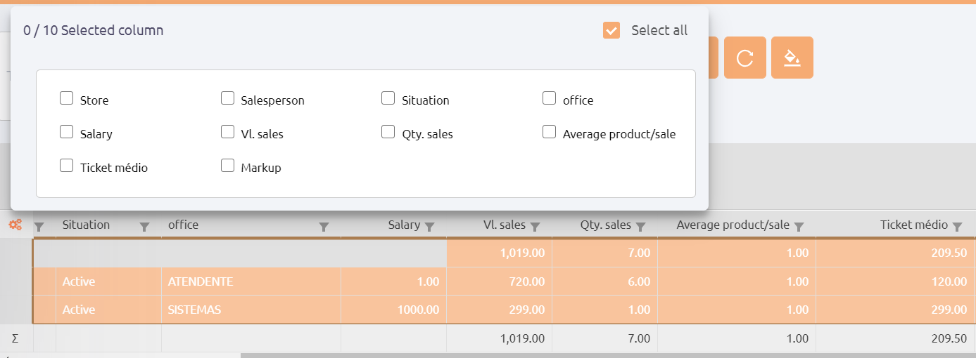

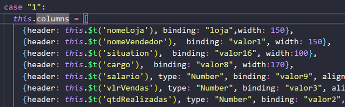

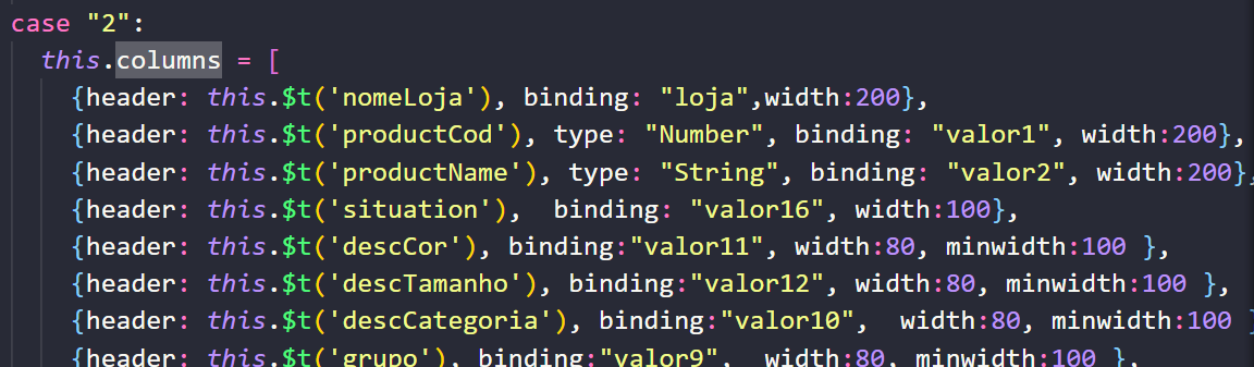

    I’ve done it with different tables but the difference with this one in particular is that its columns change every time you choose an option (I’m sending an image to a better understand of this situation).

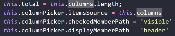

    I’ve declared the picker refference to the array because it wasn’t finding any columns before.
    Is there a way to make the column picker work? This is how the code is.
    Notice that the columns are not selected but they still show none the less

    I don’t know why but I could solve the issue by inserting the columnPicker reference inside the initializeGrid function, instead of the mounted function. I’m using a tab component and it refreshes the table every time the user clicks in a different tab.
    Thanks for the help.
