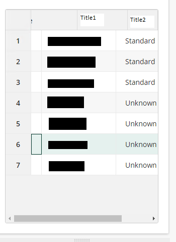

    We’re running into an issue where when a user clicks on the row header cell-any of the number cells in the far left column-the table snaps back to being scrolled all the way to the left as we expect, but the column titles don’t update to match the row data until the user starts scrolling again.
    We’re also having trouble isolating the issue to put it into a demo for use here but we will provide one when we can. Until then, is there anything you may be able to tell us about this issue?

    Sorry for the delay, but the fix turned out to be re-initializing the grid when the table automatically scrolls. Thanks for replying, though!
