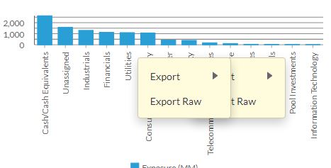

    I have multiple charts on my page and each chart is a separate component. I want to add a right-click context menu to each chart that will allow the user to export the chart to image/csv/pdf.
    The menu should be a component itself, so i can re-use it in multiple places.
    I found a good sample that is used for a grid - https://www.grapecity.com/wijmo/demos/Grid/ContextMenus/react
    I tried to convert is to use the chart but I am running into some issues the menu stays on the page and doesn’t disappear.
    I’d appreciate some help. Thank you!

    Please refer to the following demo sample showing the context menu for FlexChart. https://stackblitz.com/edit/react-7sm2dt?file=ContextMenu.js
    We have not modified the Menu options, you may modify them as per your need.
    Hope it will help!
