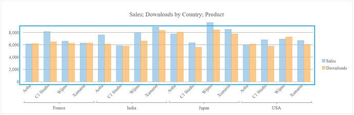

    Could you please confirm whether you are referring to the selected part in the image below as the series-group?
    If you are, then you may use the cssClass property of Series class to add a custom class for customization. Please refer to the sample link below:
