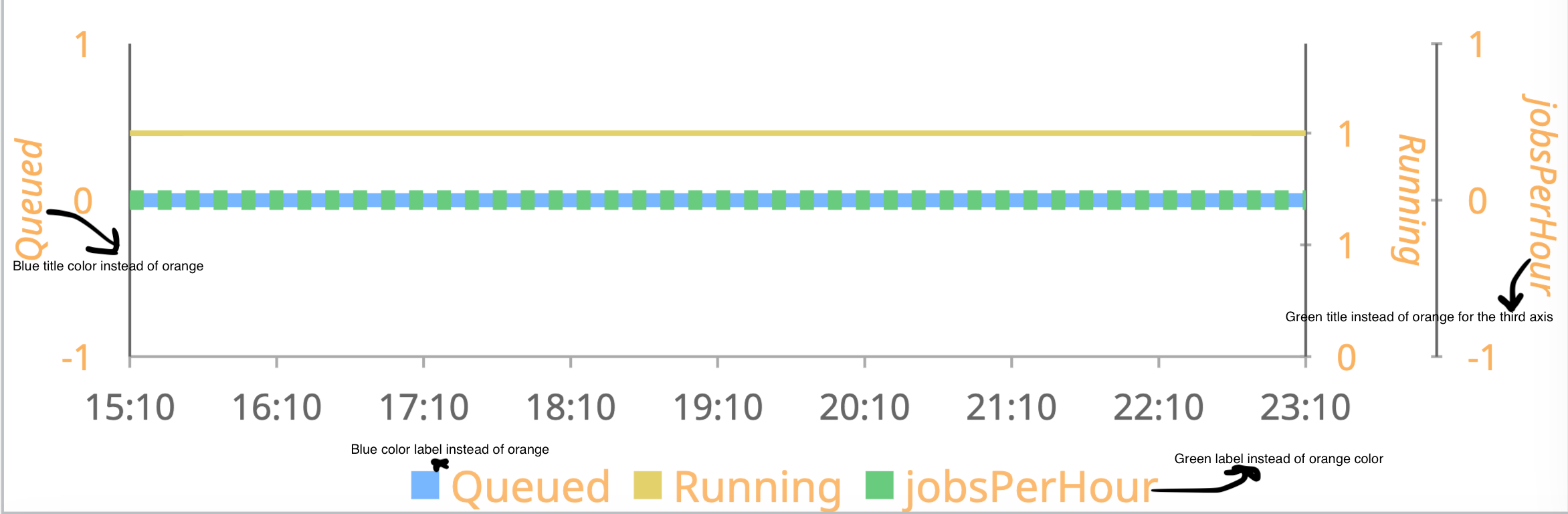

    Using the css properties it addes custom color to all the labels and title of the series.
    Code:
    .wj-flexchart .wj-axis-y .wj-title{
    fill:rgb(251, 178, 88) ;
    .wj-flexchart .wj-label{
    → Is there a way to add different custom color to individual the labels and title of the different series and axis?. The above code adds the properties to all the elements of the flexchart consisting of multiple axis as shown in the image.

    For formatting different axis labels and legend items, you will need to customize their host elements directly. Please refer to the sample below for reference:
    https://stackblitz.com/edit/angular-zqsbql
  • Posted 6 May 2020, 3:11 pm EST
    The code demo in the response is related to angular, could you show the same using react.
  • Posted 7 May 2020, 1:29 am EST
    Please refer to the link below for the sample in react:
    https://stackblitz.com/edit/react-arkq7p
