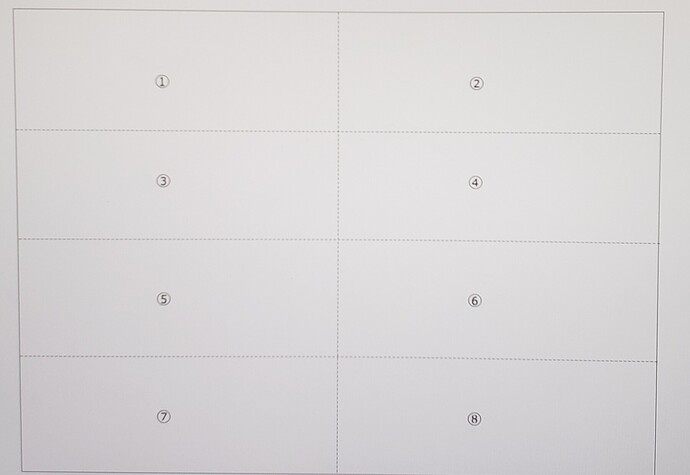

    I want to divide the Page Body Of PDF into 8 equal parts to drawing chart in each (Please refer to the attached file).
    • Can i do it and how.
      Please support me.
    Best regard.

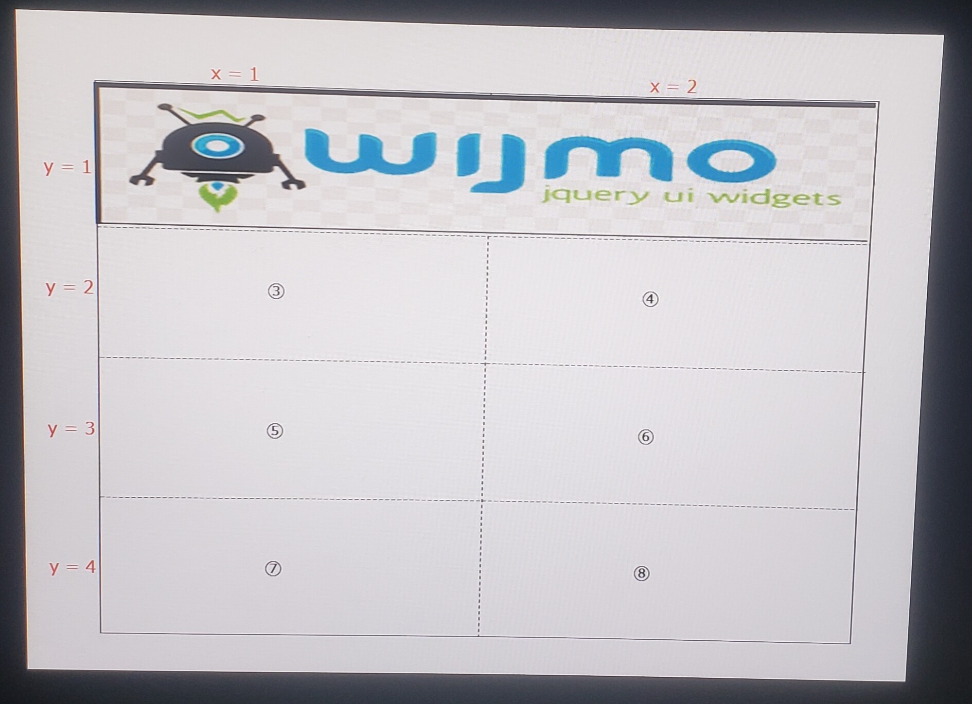

    I want divide the Page Body Of PDF into 8 equal parts to drawing chart in each (with x = 2, y = 4).
    For example: if i input x = 2, y = 1 then output pdf then the result will be like this.
    bothered but asked for help.
    Best regard.
