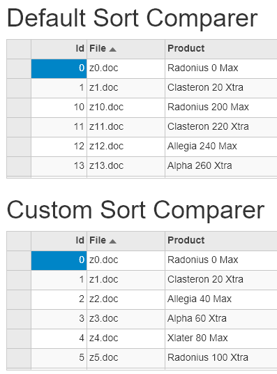

    It took a while, but we finally added this new feature to the CollectionView class in build 167+. It is documented as follows:
    CollectionView.sortComparer
    Gets or sets a function used to compare values when sorting.
    If provided, the sort comparer function should take as parameters two values of any type, and should return -1, 0, or +1 to indicate whether the first value is smaller than, equal to, or greater than the second. If the sort comparer returns null, the standard built-in comparer is used.
    This sortComparer property allows you to use custom comparison algorithms that in some cases result in sorting sequences that are more consistent with user’s expectations than plain string comparisons.
    For example, see Dave Koele’s Alphanum algorithm. It breaks up strings into chunks composed of strings or numbers, then sorts number chunks in value order and string chunks in ASCII order. Dave calls the result a “natural sorting order”.
    The example below shows a typical use for the sortComparer property:
    // create a CollectionView with a custom sort comparer
    var dataCustomSort = new wijmo.collections.CollectionView(data, {
      sortComparer: function (a, b) {
        return wijmo.isString(a) && wijmo.isString(b)
          ? alphanum(a, b) // custom comparer used for strings
          : null; // use default comparer used for everything else
    I have included a screenshot that shows the difference between the standard and “natural” sort orders.
    Thank you for the suggestion and patience.

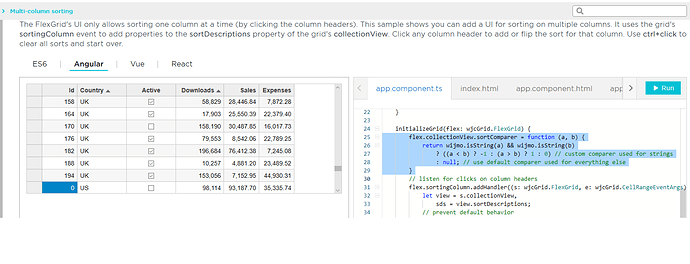

    We just tracked down an issue where our multi-column sorting was no longer working after upgrading to a more recent version of Wijmo. In our grids, we allow the user to sort by more than one column by holding down the Shift key, and we also provide custom sorting that is very similar to what @Bernard suggested above. It turns out that custom sorting breaks multi-sorting. I’ve demonstrated this issue using your ‘Multi-column sorting’ demo, as shown in the attached screenshot. This was working for us in an older version of Wijmo. Can you provide a workaround, or let us know when a fix might be available?
    Terry
  • Posted 18 October 2019, 3:39 am EST

    We are able to replicate the issue at our end and we have forwarded this issue to the concerned team for further investigation. Also, we have tried with older builds e.g 2018v1 onwards but the sortComparer method does not trigger for the current clicked column.
    Please let us know the build version in which it was working fine.
    Here is the sample for your reference:
    https://stackblitz.com/edit/angular-5vg9r9?file=src/app/app.component.ts
