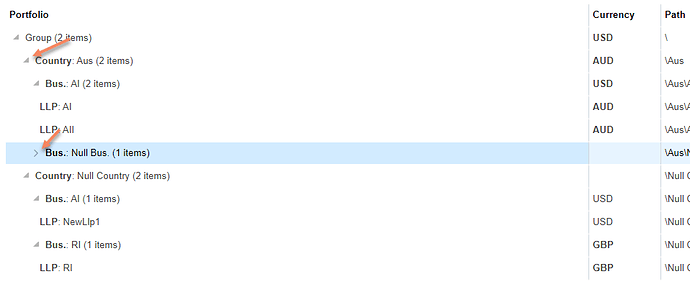

    We use wijimo Flexgrid as a treegrid, and would like to change the expand/collapse icons to ‘+’ and ‘-’, can you show us how to achieve that?

    You may handle the formatItem event of the FlexGrid and replace the expand/collapse icons placed inside the cell elements with the plus/minus icons respectively. Please refer to the sample link below demonstrating the same:
    https://stackblitz.com/edit/js-1yxnqz?file=index.js

    it works,thanks
