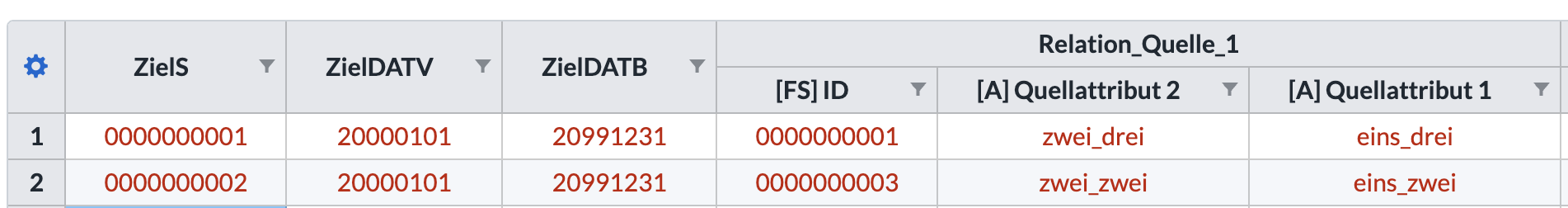

    Displaying and editing the grouped columns works just fine. However, when programmatically creating a new row by using “this.data.addNew()”, the objects for the grouped columns are missing in
    this.flexdata.selectedItems[0].attributeValue[attribute.id]
    Therefore, when trying to set
    this.flexdata.selectedItems[0].attributeValue[attribute.id].content = value
    I get an TypeScript error.
    In the following example, when printing out row 1 or 2 in the console, there are six attributes. But when printing out the newly created row, there are only 4 attributes. The ones for “Quellattribut 1” and “Quellattribut 2” are missing.
    Is there anything specific about data.addNew() that might cause this issue?
