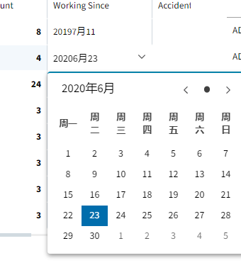

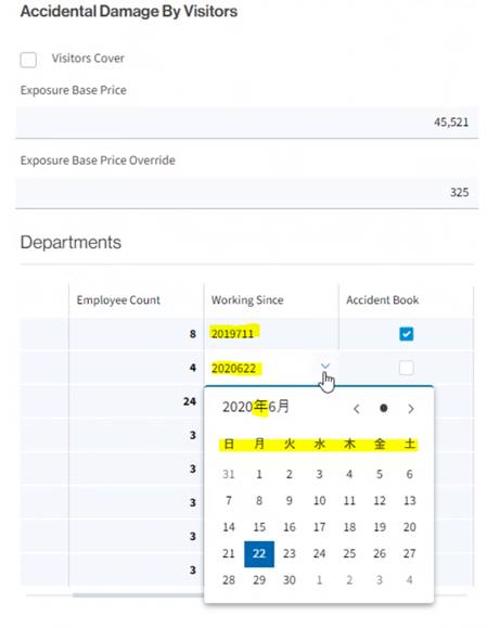

    We are using wijmo flexgrid to display and modify some data in a form
    When we apply ja culture on flexgrid, formatted date value doesnot include Japanese charaters.
    But Chinese and French cultures works as expected.
    Version using: “@grapecity/wijmo.angular2.all”: “~5.20193.637”
    Please take a look

  • Posted 24 June 2020, 3:32 am EST
    Hi Ashwin,
    I tried above example, it works for yyyyMMMMdd but not for yyyyMMMdd.
    We are using yyyyMMMdd and it works for most other culture we have tested. But it looks like Japanese works only with MMMM.
    Is that expected behavior?
    Arun
  • Posted 25 June 2020, 1:01 am EST
    Hi Arun,
    This is an expected behavior. I also tried the same with dot net and the similar behavior occurs in dot net also. It seems that the Japanese culture only displays the month name while using MMMM.
