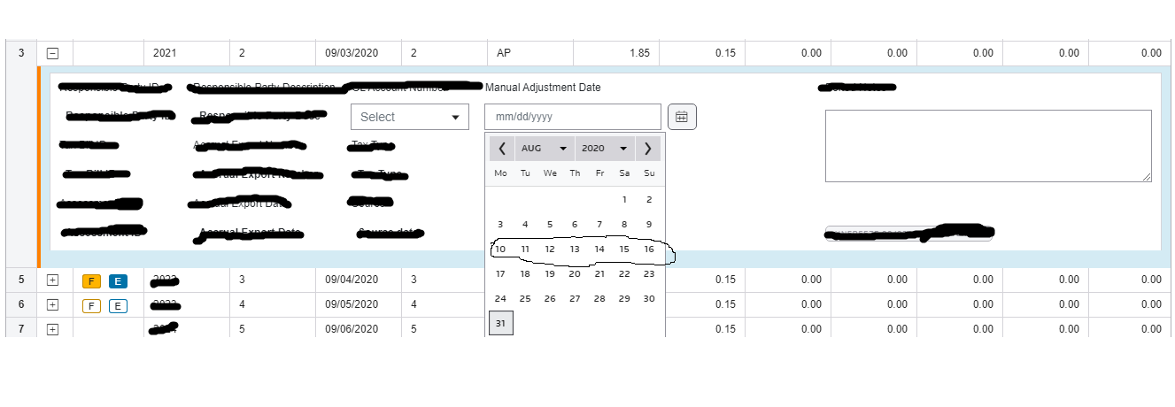

    Hi Team,
    We are unable select the dates which are outside scope of the details grid row. PFB screenshot for reference.

  • Posted 2 September 2020, 10:52 am EST
    Hi Ashwin,
    we are using bento date picker control which I cannot use in sample to reproduce the issue.
    I have used the in our code and I did not see any issue selecting date values outside scope of grid detail.
    the issue could be with the bento datepicker.
    Is there any way to give a fixed height to wijmo grid details section, so that we can increase the height to an extent our date control when toggle will be in the scope?
    When I try to select the dates which are outside scope of details screen, noting will happen, No date will gets selected.

  • Posted 3 September 2020, 2:10 am EST
    Hi Kranthi,
    Does the drop-down element of the bento-date is added as a child of the document.body or the child of bento-date itself? If it is added as the child of bento-date, then you can call the autoSizeRows method of FlexGrid to resize the rows when the drop-down on the date component is displayed.
    You can also try increasing the z-index of the date drop-down.
    Let me know if any of the suggestions work.
