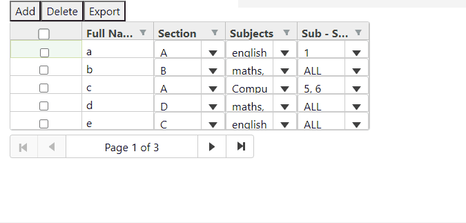

    Hi team,
    In the below snippet, If i Select rows from different pages then If I press delete button then It changes color of rows shown in the current pages but it doesn’t changes the color of all rows on different pages.
    On pressing Delete button it should change the color of all the selected rows in all the pages.
    https://stackblitz.com/edit/angular-yykuqr?file=src/app/app.component.ts
    Please provide solution for this.

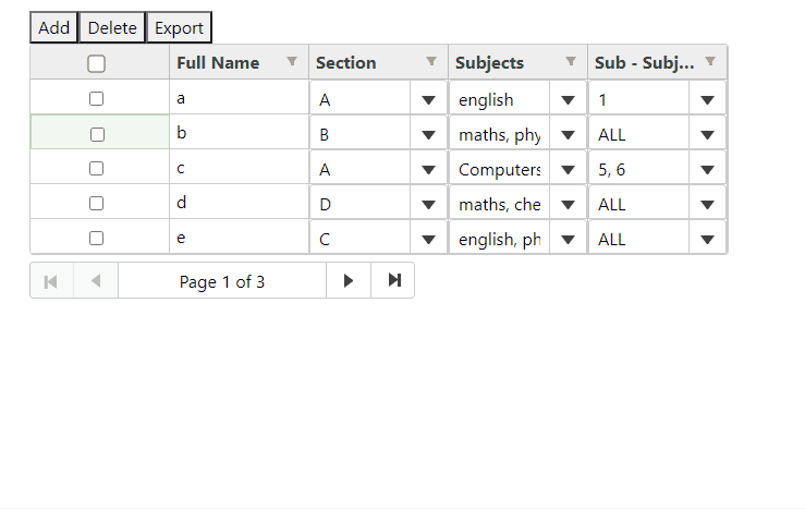

  • Posted 27 August 2021, 2:12 am EST - Updated 3 October 2022, 12:37 pm EST
    Hi Ashwin,
    Understood the above solution logic and it’s working fine but in our snippet if we selected the filtered data using select-all header and delete it, then it is changing color of all the rows ( in all pages if we clear the filter ).
    Code: - https://stackblitz.com/edit/angular-eeityr
    Attached a gif for your reference
    Please look into this.

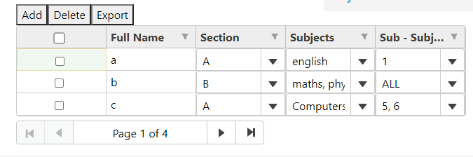

  • Posted 31 August 2021, 7:27 am EST - Updated 3 October 2022, 12:37 pm EST
    Hi Ashwin,
    The color is getting applied to rows which are not selected as well.
    I’ve attached the gif to demonstrate the issue.
    I’ve selected [b]2 rows from page one , 2 from page 2nd and etc. [/b. and if I press delete and go back I can see on 1st page more than 2 rows are getting affected. and similar behavior when we delete using select-all header.
