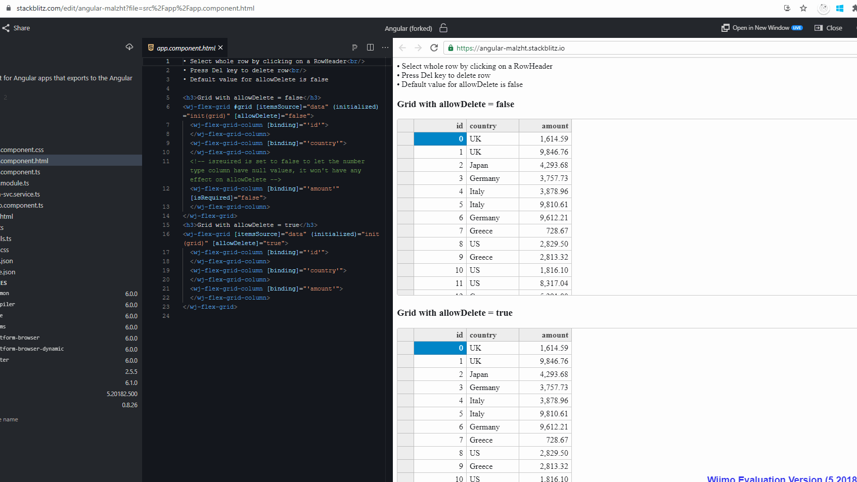

    I am seeing an issue when I try to delete all the rows from a table after editing first row and focus is in first row.
    All the rows are not deleted in this scenario.
    I can reproduce it in below link
    https://stackblitz.com/edit/angular-malzht?file=src%2Fapp%2Fapp.component.html
    Please see the gif image for reference
    Please let me know if you need any other information

    The issue here has occurred because when you were pressing the delete key the first row was still in the edit mode. To resolve the issue you need to first commit the edits before the delete operation, for that, you may add a keydown event listener to the FlexGrid and on delete keypress you can commit the edits using commitEdit method of collectionView before the delete operations can be done.
    You may refer to the sample link below for reference:
    https://stackblitz.com/edit/angular-tp457c

    commitEdit() method seems to have solved the issue.
    Thanks for your support
