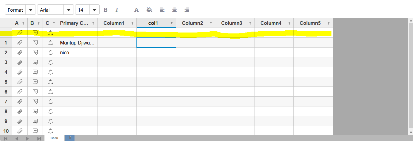

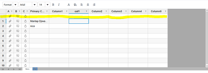

    How to detect column change so I can disable this row header visibility ? Everytime I insert new column, the row header that have been disabled before always appear.
    Could you help me with that ? Thanks.

    To hide the header row after every operation like adding a column, sorting, filtering, etc, you may need to handle the updatingView event and set the visibility of the first row of the FlexSheet to false. Please refer to the sample below:
    https://stackblitz.com/edit/angular-xdk4xm
