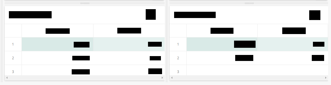

    We’re currently having an issue where on page load, disabled horizontal scrollbars appear on some of our tables. There is nothing to scroll on page load either, everything in our tables fits within the parent div that it is contained within. And when we click on any cell in the table, the disabled scrollbar disappears. Is there anything you might suggest we try that could help us hide these disabled scrollbars when there is nothing to scroll?
  • Posted 28 June 2021, 8:01 am EST
    From the screenshot, it seems like, some CSS in your application is setting the overflow property of the FlexGrid making the grid to display scrollbar even though it is not required. Please make sure that grid’s overflow property is not updated by any of your application’s custom CSS. If the issue persists please share a small sample that replicates the issue so that we could further investigate the root cause of the issue and assist you accordingly.
