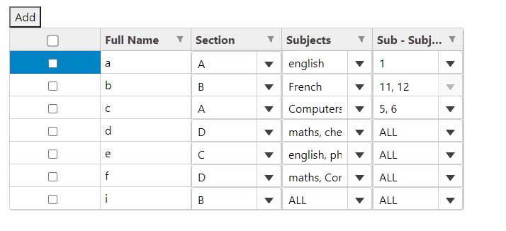

    Hi Team,
    I’m facing an issue and reproduced the same issue in the below snippet.
    https://stackblitz.com/edit/angular-zj7dgw?file=src/app/app.component.ts
    Steps to reproduce the issue : -
    1. Click on the subsubjects dropdown and without closing it, click on the subjects dropdown. - Now the dropdown of the subsubjects is getting stuck.
    2. Click on the subsubjects dropdown and without closing it, click on the sections dropdown- in this case also subsubjects dropdown is getting stuck.
    3. Click on the subjects dropdown and without closing it, click on the sections dropdown- in this case subjects dropdown it getting stuck.
    I’ve added the below extra code -
    1. for subjects : -
     isDroppedDownChanged: s => {
                if (s.isDroppedDown && s.checkedItems.length === 0) {
                  s.text = null;
                  multiSel.inputElement.value = '';
                  item.subjects = [];
                  const subSubjectsColIndex = grid.columns.getColumn('Subsubjects')
                    .index;
                  const rng = new wjcGrid.CellRange(rowIndex, subSubjectsColIndex);
                  item.Subsubjects = [];
                  grid.refreshRange(rng);
    1. for subsubjects -
                  s.text = null;
    1. for sections : -
                  s.text = null;
                  item.section = [];
                  const subjectsColIndex = grid.columns.getColumn('subjects').index;
                    .index;
                    rowIndex,
                    subjectsColIndex,
                    rowIndex,
                    subSubjectsColIndex
                  item.subjects = [];
    isDroppedDownChanged i’ve added to clear the value on click of the dropdown if it is not present in the dropdown.
    Example - this can be observed in
    2nd row - Subjects = " French" it not present in the subjects dropdown so it’s value should get cleared when i click on the subjects cell dropdown.
    After adding this code my above issue started to occur.
    Please provide solution for the above issue.

  • Posted 25 June 2021, 8:06 am EST
    Hi ashwin,
    Add a new row and you’ll be able to replicate the issue.
    OR clear French , then also it’ll behave the same way.
  • Posted 28 June 2021, 9:33 am EST
    This issue is arising because every time when the isDroppedDownChanged event is fired and checkedItems length is 0, subSubjects column’s cell range is being refreshed, And subsubjects column’s dropDown remains open due to cell range refresh.
    To overcome this issue, You may update the if condition inside isDroppedDownChanged event as follows -
                if (
                  s.isDroppedDown &&
                  s.checkedItems.length === 0 &&
                  multiSel.inputElement.value != ''
                  item.subjects = [];
                    .index;
    For better understanding, you may refer to the below code sample -
    https://stackblitz.com/edit/angular-cwpzvg?file=src/app/app.component.ts
