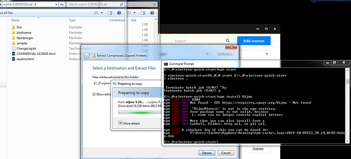

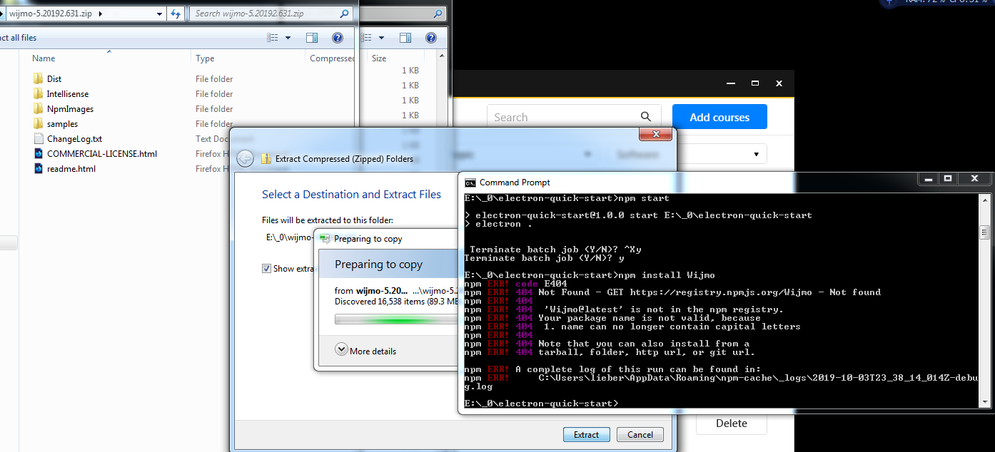

  • Posted 3 October 2019, 7:45 pm EST - Updated 3 October 2022, 7:07 pm EST
    Following: https://www.grapecity.com/blogs/how-to-build-electron-app-with-javascript-ui-controls
    Shall try downloading, installing and running again. Screenshot of error:
    Am really excited about FlexGrid and would like to discover HOW to use.
  • Posted 3 October 2019, 7:54 pm EST
    resolved… npm install wijmo (LOWERCASE)

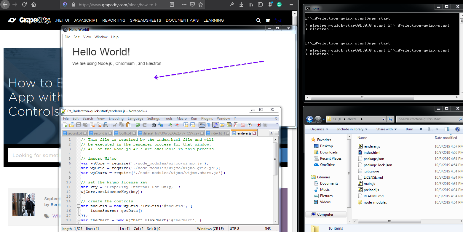

  • Posted 3 October 2019, 8:04 pm EST - Updated 3 October 2022, 7:07 pm EST
    The tutorial does not render the grid after following the instructions.
    Modified both index.html and renderer.js
    End result is in the screenshot above. Grid and Chart are not being rendered.
    Any suggestions greatly appreciated.
  • Posted 4 October 2019, 1:27 am EST
    The issue occurs because Nodejs is not integrated into the electron app. When this tutorial was written, Nodejs was integrated into the electron app by default but this has been changed. So, to run the sample, all you have to do is update the main.js file to enable node integration:
    mainWindow = new BrowserWindow({
        width: 800,
        height: 600,
        webPreferences: {
          preload: path.join(__dirname, 'preload.js'),
          nodeIntegration: true
    Also, the npm namespace has been changed from ‘wijmo’ to ‘@grapecity/wijmo’. So, I would highly recommend you to use this instead of wijmo. You can read about it more on the link below:
    https://www.grapecity.com/blogs/wijmo-npm-package-changes
    You may refer to the sample attached.

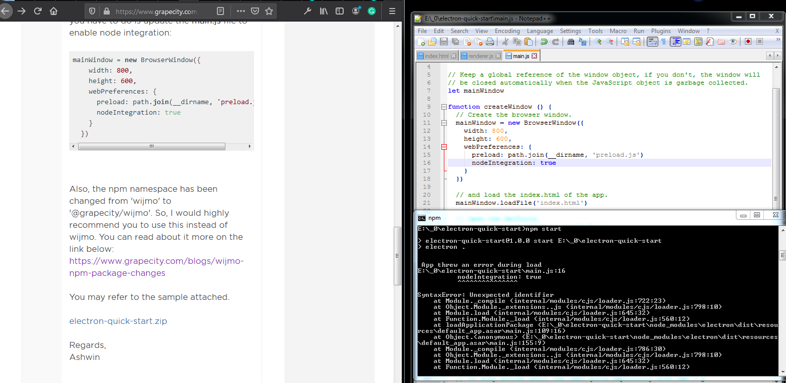

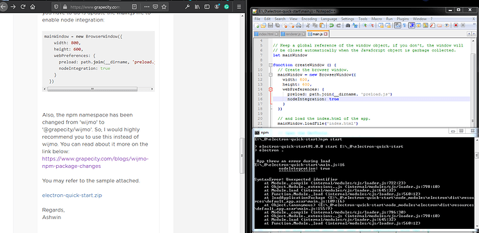

  • Posted 4 October 2019, 10:23 am EST - Updated 3 October 2022, 7:07 pm EST
    Syntax error:

  • Posted 7 October 2019, 3:16 am EST
    It seems that your issue has been resolved with the shared sample in previous comments.
    We will try to find out the issue cause for the attached image and share as we have an update on this.
