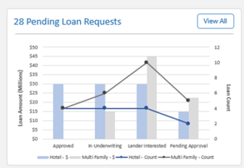

    Can we implement Dual Y Axis in Wijmo Flex chart as shown in figure below:

    Hi Reeshabh,
    To add another axis to the FlexChart, you simply need to create a new element and assign this axis to any of the series as required:
    <wj-flex-chart [itemsSource]="data"
        [bindingX]="'country'" [itemFormatter]="chartFormatter">
        <wj-flex-chart-axis #axis3
          [axisLine]="true"
          [position]="'Right'"
          [minorGrid]="true"
          [title]="'Downloads'">
          <wj-flex-chart-axis #axisy
          [axisLine]="true"
          [minorGrid]="true"
          [wjProperty]="'axisY'"
          [title]="'title'">
          </wj-flex-chart-axis>
         <wj-flex-chart-series [name]="'Sales'" [chartType]="'Line'" [binding]="'sales'"></wj-flex-chart-series>
         <wj-flex-chart-series [name]="'Expenses'" [binding]="'expenses'"></wj-flex-chart-series>
         <wj-flex-chart-series [name]="'Downloads'" [axisY]="axis3" [binding]="'downloads'"></wj-flex-chart-series>
     </wj-flex-chart>
    Please refer to the sample below:
    https://stackblitz.com/edit/angular-1psvrr
