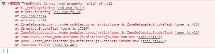

    I’m getting an error while trying to paste from excel.

  • Posted 13 December 2019, 12:53 am EST
    an error occurs when I paste multiple line.
    “Halo
    there
    hai”
    And normal when I paste single line
    “Halo there hai”
  • Posted 16 December 2019, 12:08 am EST
    Hi Oskar,
    From the console error, it looks like your instance of the Sheet object of the FlexSheet is null. Could you please explain more about the function you are performing in the pasted event.
    As per my understanding, it looks like you are trying to recreate the data source of the FlexSheet after pasting. Is my understanding correct?
