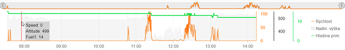

    in my application I am having a main graph with several axes and an additional graph for scaling (see image attached). The problem is that users can switch on/off axes of the main graph. When they do it, main graph changes its width but scaling graph remains the original width.
    Is there any way to make scaling graph obtain same width as the main graph when the main graph changes its width?

    You may handle the rendered event of the FlexChart and get the width of its plotArea element and set the width of the range selector accordingly. Please refer to the sample below:
    https://stackblitz.com/edit/angular-rtbzt1
    Let me know if this was your requirement or otherwise.

      yes, this seems to work. I've had some problems synchronizing both charts precisely but finally managed to make them work together nicely according to your example.
