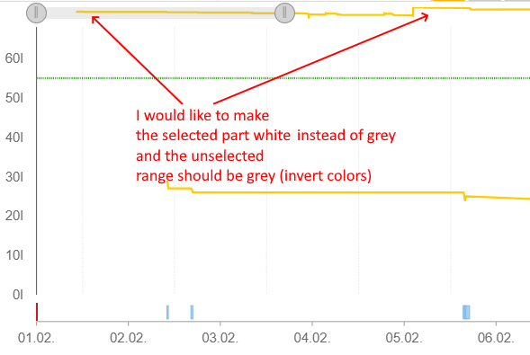

      is it please possible to invert the colors of selected and unselected ranges in FlexChart range selectors (please see screenshot)? I would like to make the currently selected area in range-selector white and the unselected area should become grey?
    Is it possible to achieve?

    Sorry but this will not be possible because of how the RangeSelector is designed. The selected part is the child of the whole range selector. In order to fulfill your requirement, we will need to add a little transparency to the whole selector and make the selector completely transparent.
    But, if we will make the selector completely transparent, then the background of the complete range will be displayed instead of the chart’s background. Therefore, the background of the complete selector will always be displayed.
