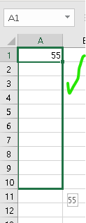

    Now, I need help to slightly modify the drag and drop. The data cannot go to a different column, so I can only drag and drop across rows, but not across columns.
    * “Here is what I want:”
    Notice the data staying only in 1 column
    * “Here is what I do not want:”
    Notice how the data is going across columns. I don’t want this:
