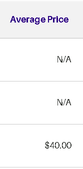

    * “Issue 2: One of my columns won’t even sort”
    I have a column called "Average Price’ and behind the scenes, this column can be a currency value (such as $5.50) or it can display the value “N/A”
    For some reason, this column will not sort at all. I can put the code example. I am suspecting it’s not sorting because it needs the entire current “View” to sort properly.
    Here are the code examples for this column:

    2). In the provided code snippet, We could observe that binding property is missing, For sorting to work correctly, column needs to be bounded to some value that is used for sorting. Please make sure that binding property is set for the columns and let us know if the issue persists for you.
