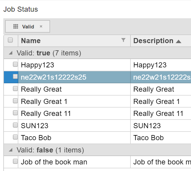

    Hello, we implemented a checkbox cell in the 1st column so users can select rows. It all works and looks fine:
    However, when the user adds a group, then the 1st column checkboxes get 20px extra left padding added and it’s not centered anymore:
    Is there a way to prevent the 1st column from getting indented? It doesn’t look like simple classes can be overridden since the 20px left padding is added to the cell directly in code, it seems.

    Hi Scott,
    You may add a cssClass to the first column (in which you have added the checkboxes) and use that class to remove the padding from the input element.
    In app.component.html:
    <wj-flex-grid-column [width]="40" cssClass="align-center" [isReadOnly]="true" align="center">
        <ng-template wjFlexGridCellTemplate [cellType]="'Cell'" let-cell="cell">
          <input type="checkbox" [(ngModel)]="cell.row.isSelected" [checked]="cell.row.isSelected" />
        </ng-template>
      </wj-flex-grid-column>
    In styles.css:
    .align-center.wj-cell:not(.wj-group) {
      padding-left: 6px !important;
    You may refer to the sample below:
    https://stackblitz.com/edit/angular-vtvwdy

    That worked. Thanks!
