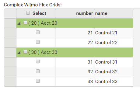

  • Posted 14 September 2017, 11:08 am EST
    In my case in my itemsSource collection I have accountNumber and accountName. I am grouping my flexgrid by accountNumber but donot show that column. I want to have custom group row header and after almost spending 3 hours.I came to know about groupHeaderFormat property. I want to show my group header like this
    ( accountNumber ) accountName
    for example: ( 12 ) Wijmo Foundation Acccount. How to do this? I am working with Angular JS 4 and Typescript.
    Hi Gopal,
    Since you would like to show accountName along with accountNumber, you can not use groupHeaderFormat property. For this, you need to customize groupHeader using formatItem.
    Please use the following code snippet for customizing group header:
     if (e.panel.rows[e.row] instanceof wjcGrid.GroupRow && e.panel.cellType != wjcGrid.CellType.RowHeader) {
                var chk = document.createElement('input');
                chk.type = 'checkbox';
                chk.style.marginLeft = '6px';
                chk.className = 'custom-check-box';
                var groupData = e.panel.rows[e.row].dataItem;
                console.log(groupData);
                var cnt = 0;
                for (var i = 0; i < groupData.items.length; i++) {
                    if (groupData.items[i].active == true)
                        cnt++;
                chk.checked = cnt > 0;
                chk.indeterminate = cnt > 0 && cnt < groupData.items.length;
                // custom group header
                let span = '<span class="wj-elem-collapse wj-glyph-down-right"></span>';
                if (e.panel.rows[e.row].isCollapsed) {
                    span = ' <span class="wj-elem-collapse wj-glyph-right" > </span>';
                else {
                e.cell.innerHTML = span + '  (' + groupData.name + ') ' + groupData.items[0].country;
                e.cell.appendChild(chk);
    Please put this code in formatItem event.
    We are sorry, we cannot say much about your code snippet since you are setting groupHeaderFormat property to {myName}. But we are not able to find where you set {myName}.
    Manish Kumar Gupta
    Thanks Manish. I am able to solve my issue. flexGrid.groupHeaderFormat = ‘{myname}’; just the code to make sure the default formatter doesnot work. if I give flexGrid.groupHeaderFormat = ‘’; I am getting nothing and if I give flexGrid.groupHeaderFormat = ‘{}’; I am getting {} so I gave flexGrid.groupHeaderFormat = ‘{myname}’;
