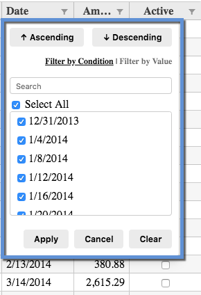

    Hi Support,
    We are looking for a way to customize flexGrid filters as shown in the attached chart. Basically we don’t want to strictly compare some date-type data. Is there a way to write our own comparator which redefines “equal”, “greater than” or “less than” logic?

    BTW, is there any way to customise the popup UI as well? We’d like to add some of our own stuff and change its look and feel a little bit. Is it possible?
  • Posted 21 June 2019, 6:57 am EST
    You may easily customize the column filter editor by using the control template property of the ColumnFilterEditor class. Please refer to the sample below:
    https://stackblitz.com/edit/angular-6jbizm
    In the above sample, if you will navigate to filter by condition, you will see that I moved the Apply, Cancel and Clear button to the top of the filter editor.
