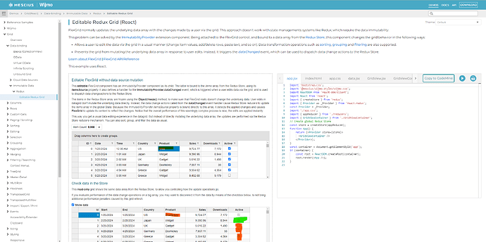

    example in the Demo doesnt work properly(see the image):
    It updates only first typed value. The rest of the flexgrid changes are not represented in the second grid.

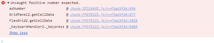

    The problem is that most of the time when I am returning new state (95% of the edits) I am getting error
    Uncaught Positive number expected. (see the second image)
    Not sure whats causing it.

    After observing the shared code snippets, it seems there is an implementation issue in the code you shared. The itemsSource should be assigned to the Immutabilityprovider component only and not to the flexgrid, which seems to be causing this issue. You can read more about it here https://developer.mescius.com/wijmo/api/classes/Wijmo_Grid_Immutable.Immutabilityprovider.html#itemssource

    Regarding the Demo on the website, thank you for bringing our notice we have escalated the issue to the concerned team. To run the demo successfully, you should remove the useEvent hook that is attached to the handler for dataChanged event of ImmutabilityProvider.

    <ImmutabilityProvider itemsSource={props.items} dataChanged={onGridDataChanged}/>
    Please find attached an updated sample for the same.
