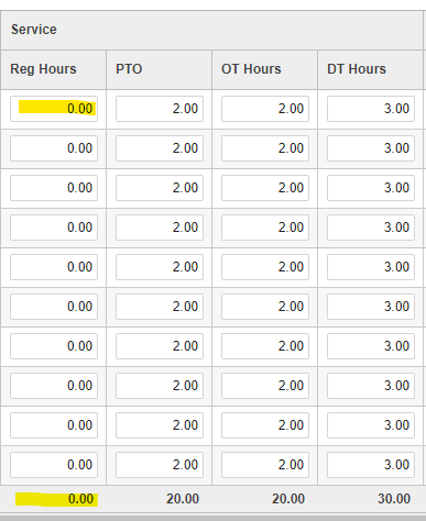

    I am currently working on a flexgrid with formatted cells that is aggregated. On initial load, it is showing the total values of the column (aggregate=‘Sum’). However, when I change the value of one cell on that column, the column footer does not update. Kindly refer to the attached screenshots:

    The value of the footer is not updating because the value of the cell is not updating. Even if you will update the value of the input element, the cell bound to the input element will not be updated. You will need to add an event listener on the input element that will update the value of the cell.
    Please refer to the sample link below for reference:
    https://stackblitz.com/edit/angular-z8ujch
