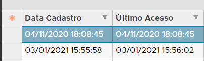

    In order to format dates, I use cellTemplate and a custom formatter since I couldn’t get the inbuilt formatter to work with custom formats. Also, I use state persistence.

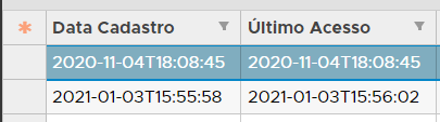

    The problem is that every column persists their state correctly, except for the date columns, which show the unformatted date string when the persisted state is loaded. I understand that the cellTemplate doesn’t aplly in persistence through the columnLayout property, and I would like to know if there is any possible workaround.
    Before persist (with cellTemplate)
    Persisted state loaded
