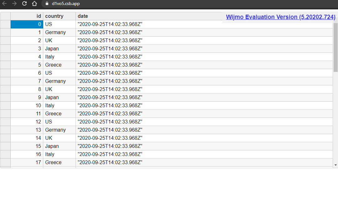

  • Posted 25 September 2020, 10:09 am EST - Updated 3 October 2022, 3:32 pm EST
    Hi Geoffrey,
    We are sorry but we are unable to replicate the issue at our end. We have attached a gif of our observation and the sample used for testing. Please have a look at it and let us know if we are missing some steps to replicate the issue.
    Sample: https://codesandbox.io/s/wijmo-angular-forked-d1vo5?file=/src/app/app.component.html
