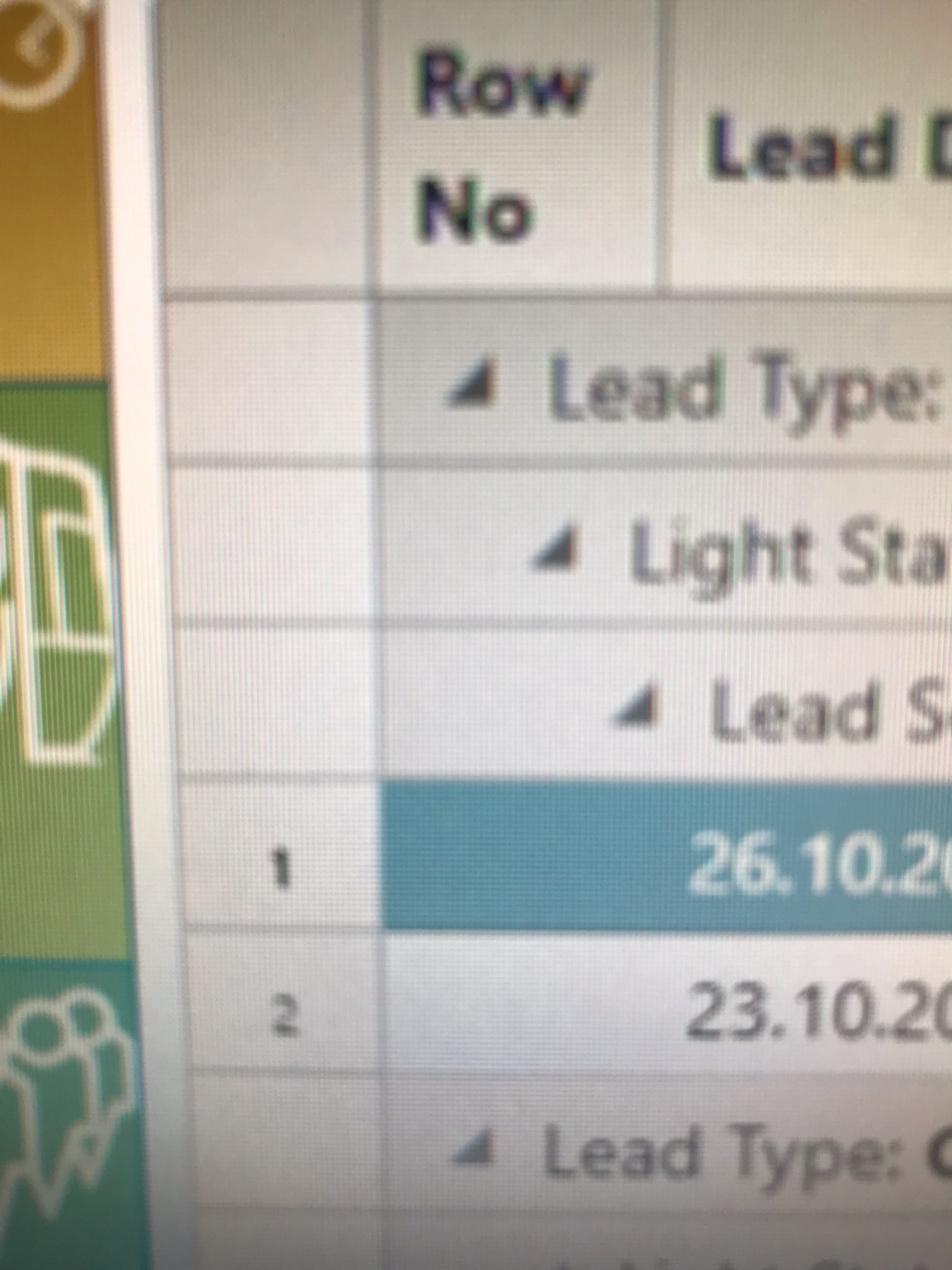

    Hello, my grid has short first column with visible value, but when someone makes some grouping of rows in grid - the left padding of first column increases and the value becomes not visible. How can I detect that and restore the previous left padding for first column cells so that the first column values stay visible? Thnx.

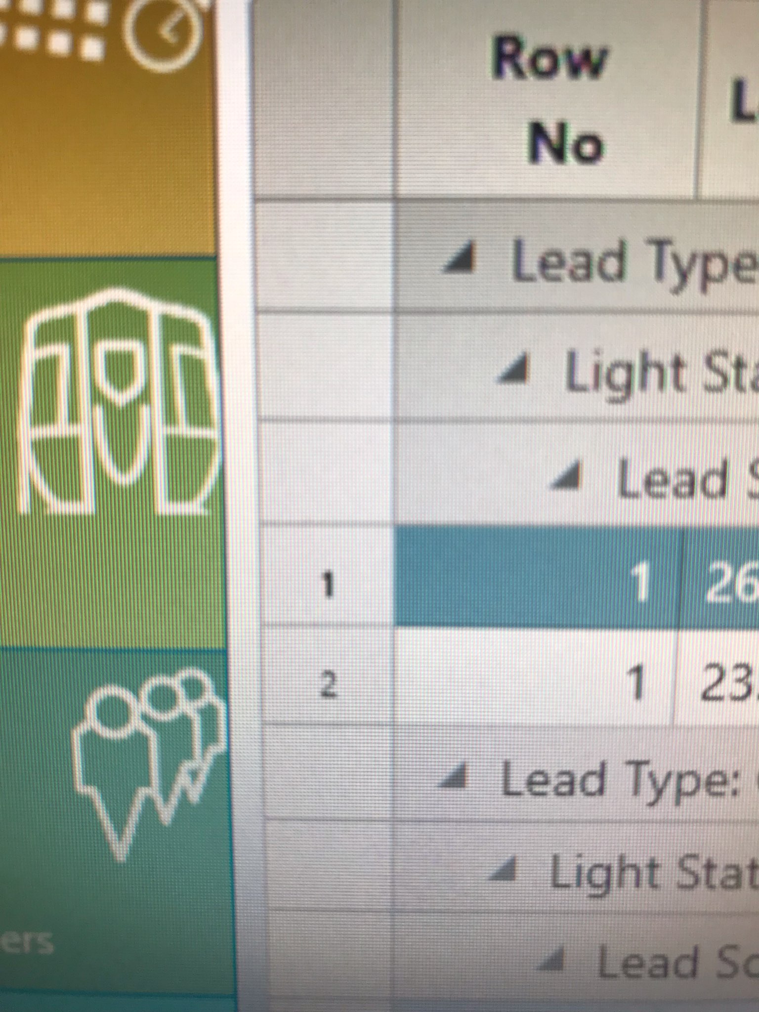

    Hi Mary,
    Could you please try setting the minWidth property of the first column to a large value? Please refer to the sample below for reference and let me know if this solves your issue:
    https://stackblitz.com/edit/js-zvqfzc
