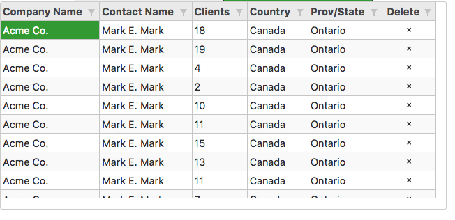

    I am noticing that on resize the grid seems to make space for horizontal and vertical scrollbars but doesn’t draw them, so there’s a thin white row at the bottom of the grid and a thin white column at the right side of the grid. (See attached screen shot).
    Do you know what causes that, and how I can prevent / clear it?

    Hello Steve,
    We are sorry, we are unable to replicate issue at our end.
    As per screenshot, it may be possible this issue is raised due to customized CSS in your project.
    We could not say a word without replicating the issue at our end.
    Please share a sample depicting your issue so that so that we can debug and assist you accordingly.

    What seems to happen is the flex-grid auto-sizes all the columns, but doesn’t fill the entire width of the container it’s in, so there’s some white space left at the right edge. I expect the same is true with it’s resizing rows, if there’s not room for a full row, there’s whitespace left at the bottom between the last full row and the container.
    If I’ve assigned relative widths to the columns (, 2 etc.), does that interfere with the autoresizing? Should I remove those [width] attributes and let auto-sizing handle it instead?
  • Posted 14 September 2017, 12:01 pm EST
    For the columns, please use one of the method either set width using [width] property or call autoSizeColumns() method for resizing column according to the cell content.
    For rows, if rows is less then height of FlexGrid, there will be white space in the FlexGrid.
    Just for your information, if you use autoSizeColumns method, it will resize according to the content and no wrapping will be performed in desired columns.
    Hope it clears !
    Manish Kumar Gupta
