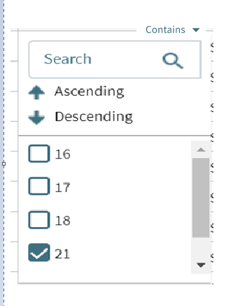

    Is it possible to achieve below mentioned Filter design for column filters with both Filter by condition as well as with Filter by options in flexgrid using react js. Please assist.

    Hi Shajiya,
    Sorry but this layout will not be possible with FlexGridFilter because the complete filter editor, value filter editor, and condition filter editor are different components. The search part in the value filter is a part of the ValueFilterEditor and the sorting buttons are a part of the ColumnFilterEditor, and we cannot merge these two different components to bring the sorting buttons below the search box.
